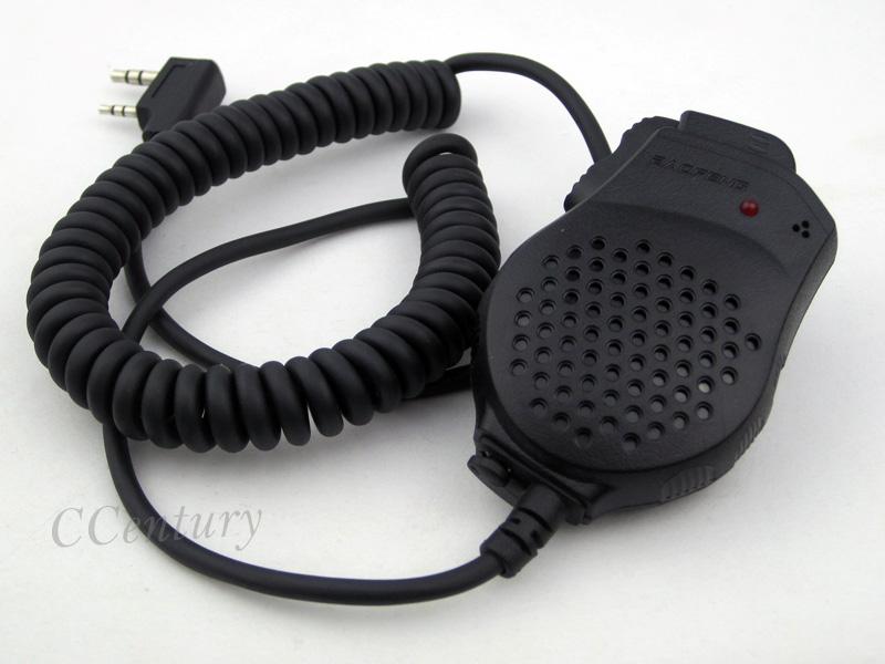

First is an A/B handmic that has two PTTs on the side.  This allows you to use the A and B sides of the radio from the handmic without having to pull the radio to mess with buttons on the face of it.  This mic (none of the dual ptt mics) will make this work with the standard UV-5R radio.

The second is a BAOFENG UV-82.  This comes in various flavors but the basic Uv-82 model is currently 40ish dollars on Amazon.  There is a "HP" model similar to the BF-F8HP (High power UV-5R) that makes 7 to 8 watts instead of the standard 5 watts.  These are just north of 60 dollars.  Anyway this radio has the ability to use the A and B "channels" at the same time without having to push the A/B button like on the UV-5R series.  With the above mic you simply pus the top part of the switch for frequency A and the bottom part of the switch for frequency B.  Easy peasy. There is a dual PTT on the radio itself as well if you don't want to run a handmic.

I'm a fan of speakermics. That first link has my interest. Now if only they would offer a button for muting on the mic itself for easy radio silence.  ^_^

in ear monitor from the jack on the handmic mutes the audio from the mic and routes it into your ear instead.
If you wear electronic ear muffs you can use a patch cord to go from the handmic into your hearing protection.  That's how I run my Howard Leights.

I could see myself running a setup like that at some point. Typically I just like the minimal fuss and crap on my head that comes with using only the speakermic (which is normally only used for keeping up with command or regrouping after respawn anyway.) But there are times that I might be on a larger group channel for platoon, and I'd like a break from some of the more chatty people.
A simple earwig might be fine I guess, but between my headgear, goggles, and mesh there's a lot going on there. Which is originally why I dropped my old bravo style headset for the speakermic in the first place.
